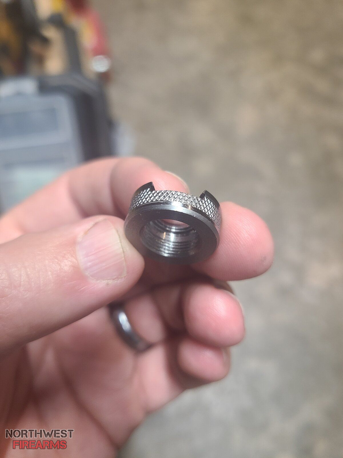

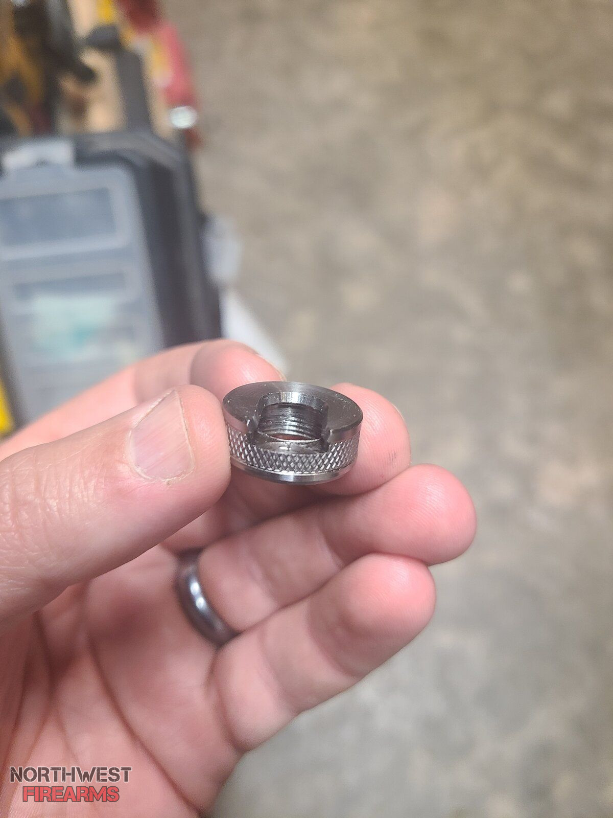

I know this is a simple question, but I seem to be missing a piece. My shell holder doesn't have a knub that seems to screw into the bottom of the holder. Clear threads on the holder. What am I missing? Thank you.
It's already been said, but that is a Lee shell holder for trimming brass using Lee's brass case trimming system not for reloading cartridges. And nobody makes an attachment to use it for reloading cartridges.
Thank you. I think I figured out I need the lee precision shell holder r4.
