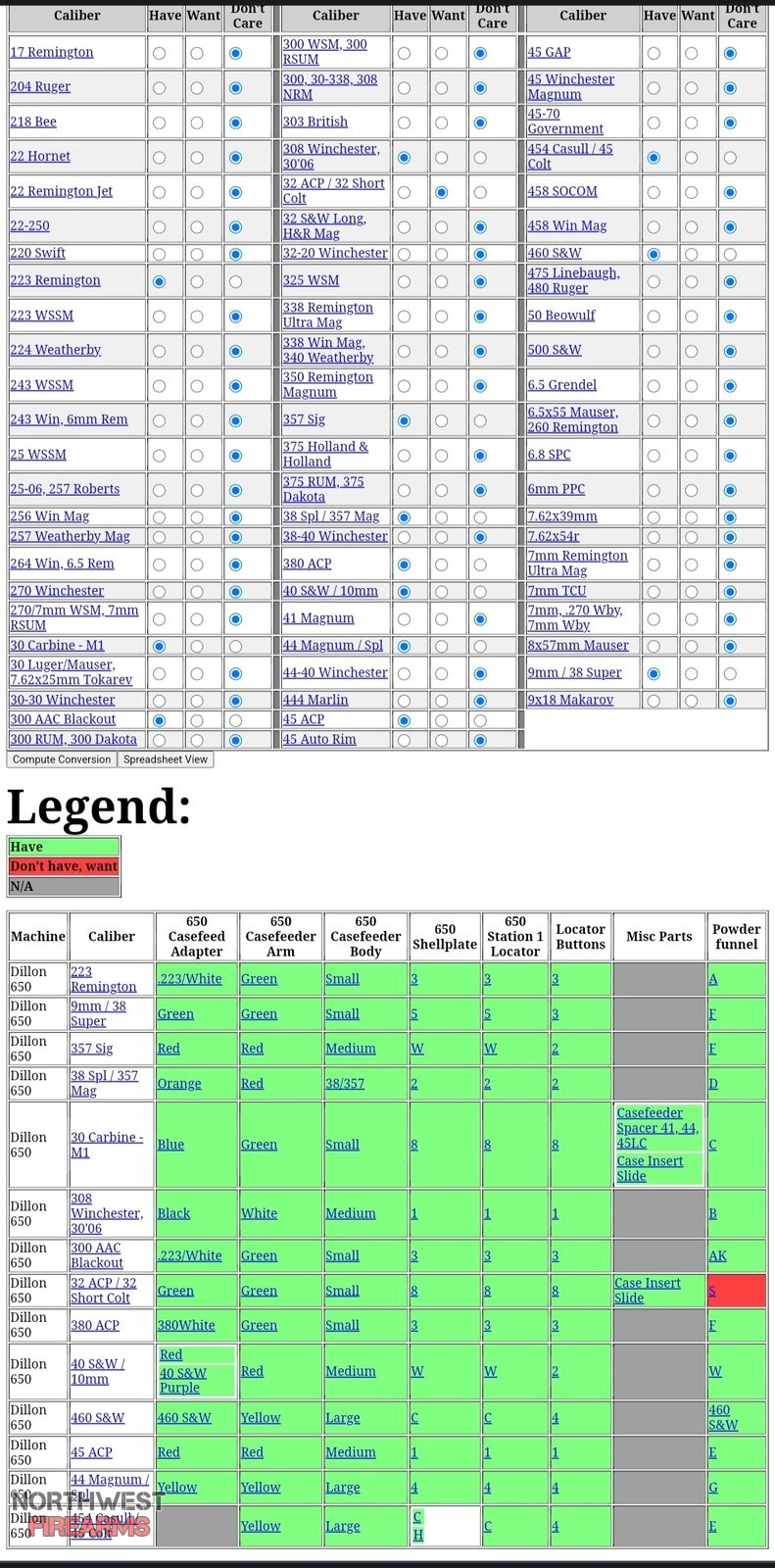

I put together a spreadhseet based off their "caliber conversion chart" which compared the conversion individual parts, the against the ones I had. .....
Used to be a website that did that for you, it's come and gone over the years, and last I checked was down again. But here is a screenshot I took when it was last functioning.
