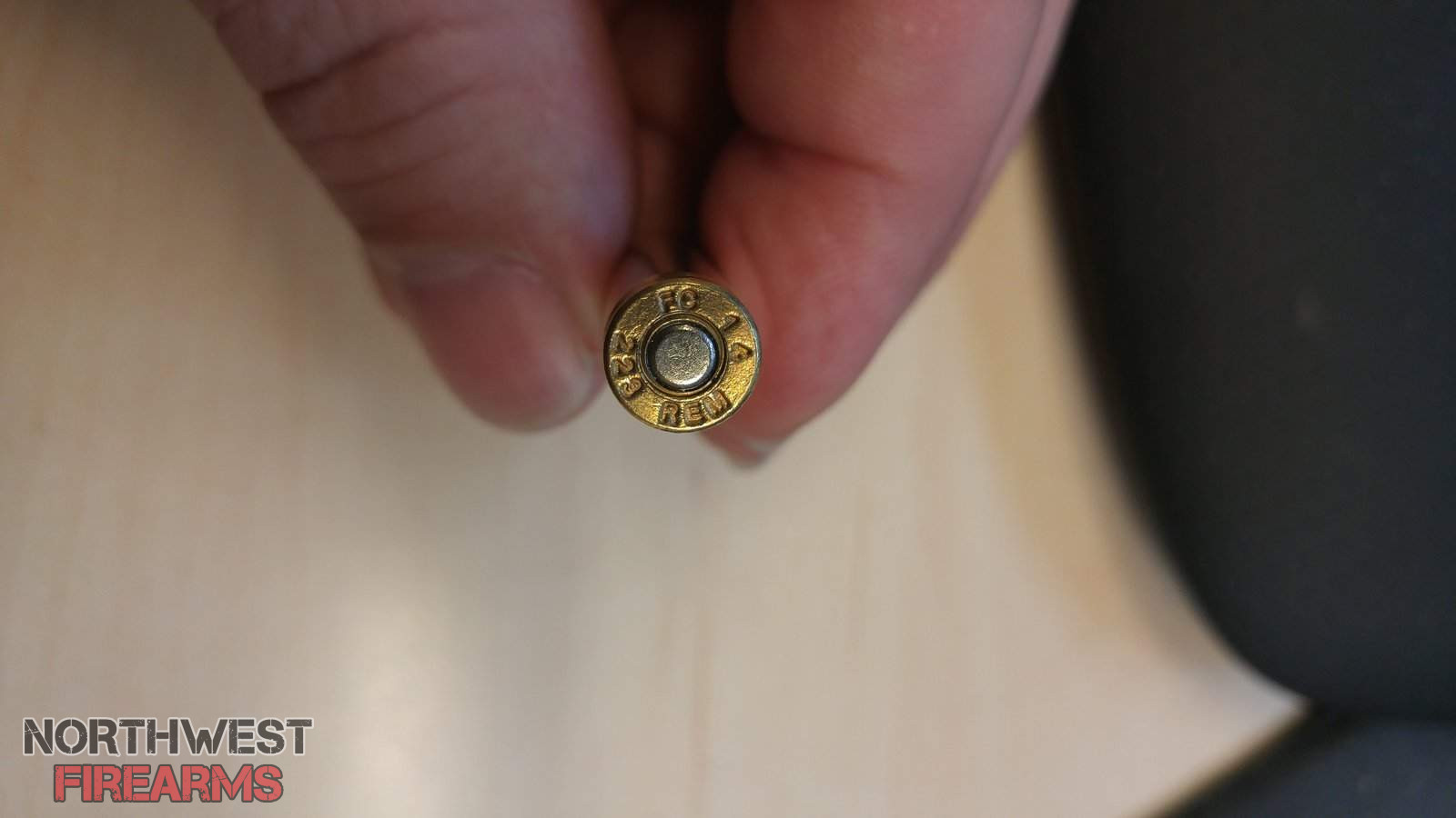

@Crohnos01 Were the head stamps all the same? You didn't really say if the rounds were hand "good ol' boy"" reloads, remanufactured, or what.
You know, I didn't really look that closely as I wasn't the one pulling the rounds apart, but now that you asked, I went over to my bench and grabbed a handful to take a closer look. Keep in mind, I don't shoot .223, so I am not intimately familiar with the round however.....

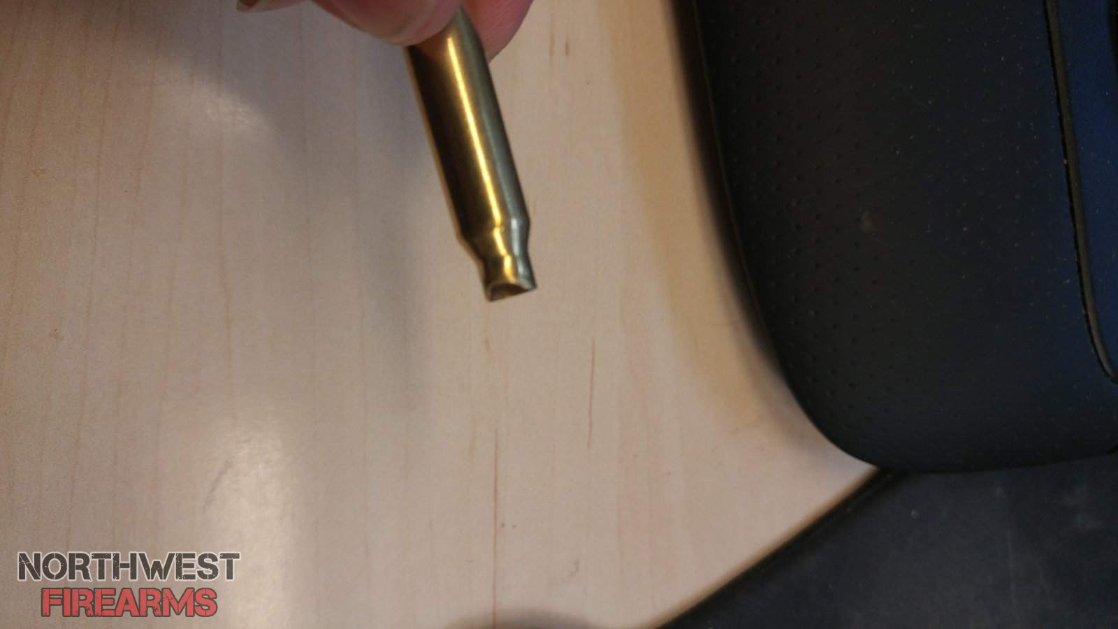

When I first examined them, it almost looked like a crimped primer, but when I looked at them closer under a magnifying glass, it looks like whatever method was used to seat the primer mangled the primer pocket around the primer.. maybe using the wrong size ram for the primer? However the headstamps seem to all be FC & LC.. at least of the half dozen I grabbed. I enclosed a couple of shots of this case after the bullet was removed.... we DIDN'T do the damage to the neck; that's the was it was in the box with the rest. Just one example of what NOT to do with reloads...o_O

View attachment 284087 View attachment 284088
Looks like maybe the original primers were crimped and the pockets maybe reamed out to accept the new primers?
I'm not familiar with what military/crimped primers look like. I've thought they were crimped in just a couple of places and not entirely around. ?shrug?
I have seen them with both a ring crimp and a three point crimping system.... not that I'm an expert mind you and I tend to try to avoid the extra work involved in removing the crimp from the primer pocket if I can.
