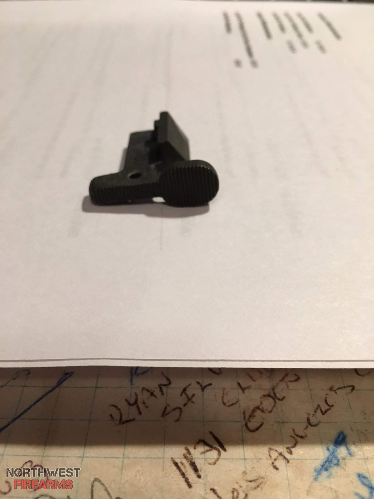

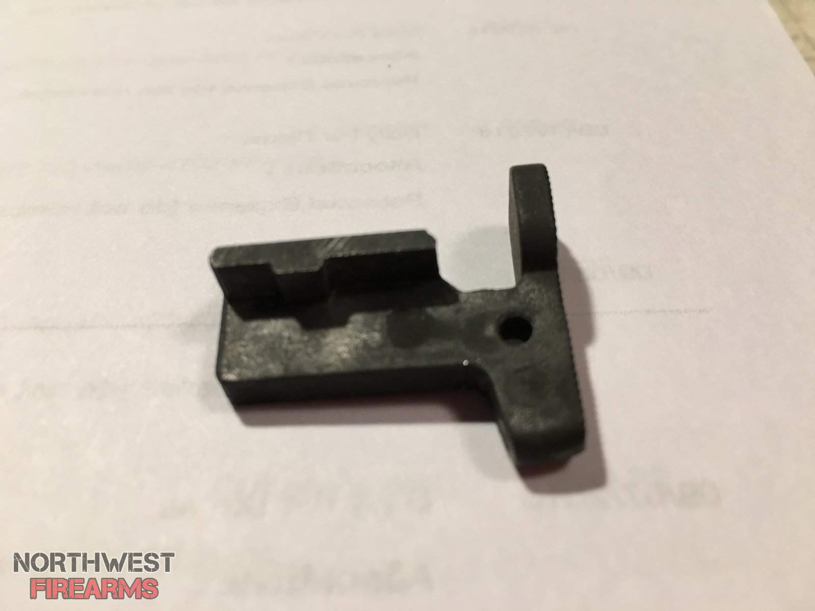

Did the paddle break off? I've had that happen, but on a standard forged AR. I just hammered out the pin (after taping everything up, of course) and replaced it with a new catch and new roll pin.
Does the Mega use a different kind?
Where did it break, got a picture? Huh after looking around some I found this pic which is supposed to be a MATEN bolt catch.
Then looking around some more I see that this
Is a DPMS part https://www.brownells.com/rifle-par...bolt-catches/308-ar-bolt-catch-prod43837.aspx
My AERO M5E1 is supposed to be DPMS and I use the V7 S7 BOLT CATCH NP3 308/DPMS/SR25
So now everything is just clear as mud to me. Just went and grabbed my homebuilt LR/308 and my bolt catch looks just like the np3 coated version above. I'm definitely a little confused why some bolt catches have the extra bit of shelf built in and others do not?
FYI the V7's black or np3 are made from tool steel not MIM junk.
