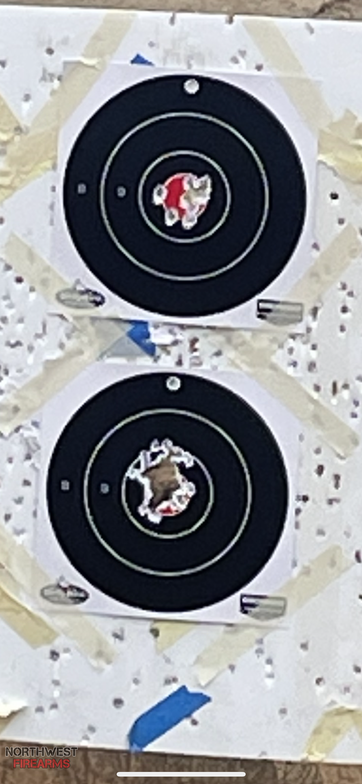

With that said, I'm not the greatest…I can yip a few here and there, but I'd like to think I'm not totally incompetent when it comes to the press. Pic attached, 210 rds from the 10yd line on 8" paper.
Locking block from a known good shooter installed. Curious to see if it has any effect tomorrow.
Can't really complain about those results.
