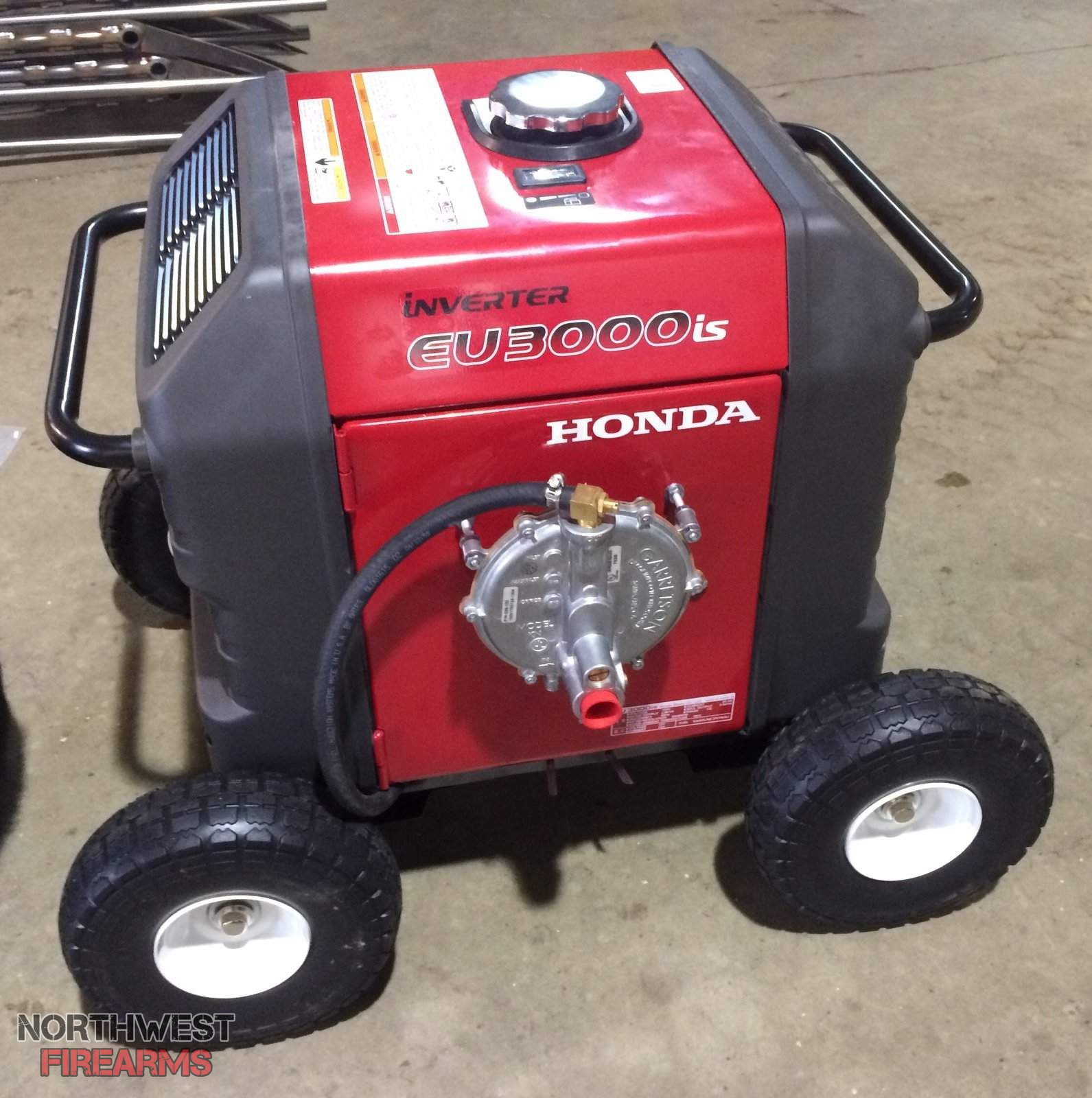

I thought I would pass this along to anyone considering the idea of converting their generator to propane or natural gas.
I purchased a kit from http://www.motorsnorkel.com and could not be happier with the results. My gen is an old Honda Super Quiet 3200W. If anyone is interested, and I have no affiliation whatsoever, check out their website and also apply their half-off code "HALFOFF"
Once installed, I set everything to their recommended turns on the regulator and the gen started right up and functions perfectly. I loaded it up and ran it for a couple hours with no problems.
Also, by adding a small petcock/on-off valve to your gasoline line, one can switch right back to gasoline if need be.
http://www.motorsnorkel.com/motor-s...st&utm_medium=email&utm_campaign=big-discount

The little guy I just bought, I got a twin without the conversion so I can run the pair parallel.
I have found even with fuel stabilizers and regular operation the gas one is still temperamental. I have switched my engine powered welder over to propane as well. I have a 500 gal bulk propane tank and can fill my own small cylinders so for me it just makes sense.
That is a cutie! Looks like a min version of mine and those wheels are a great add too. Good job!
