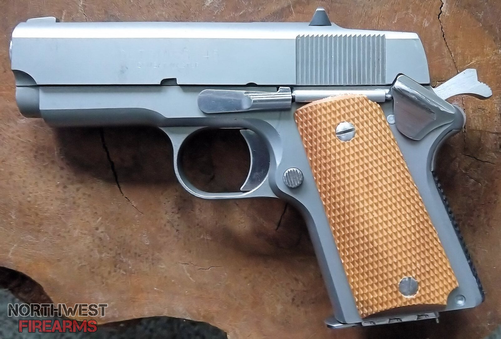

This is what it looked like on the auction site:

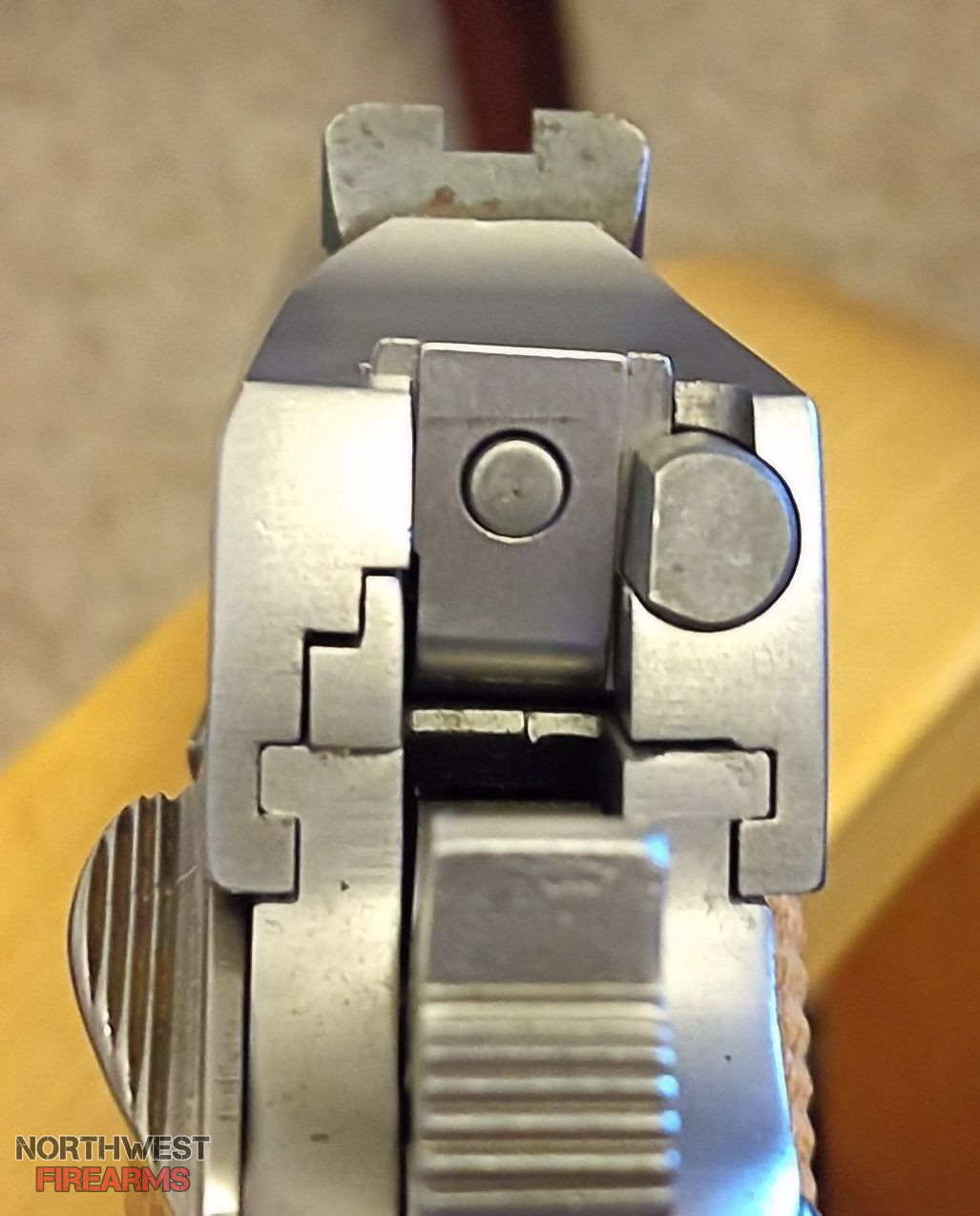

There's some metal missing from the slide, just above the extractor. It doesn't seem to be affecting the function of the gun, such as it is, but just looking around.

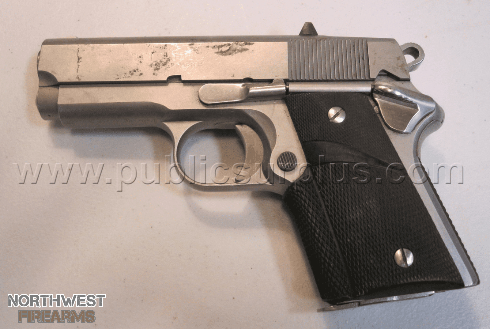

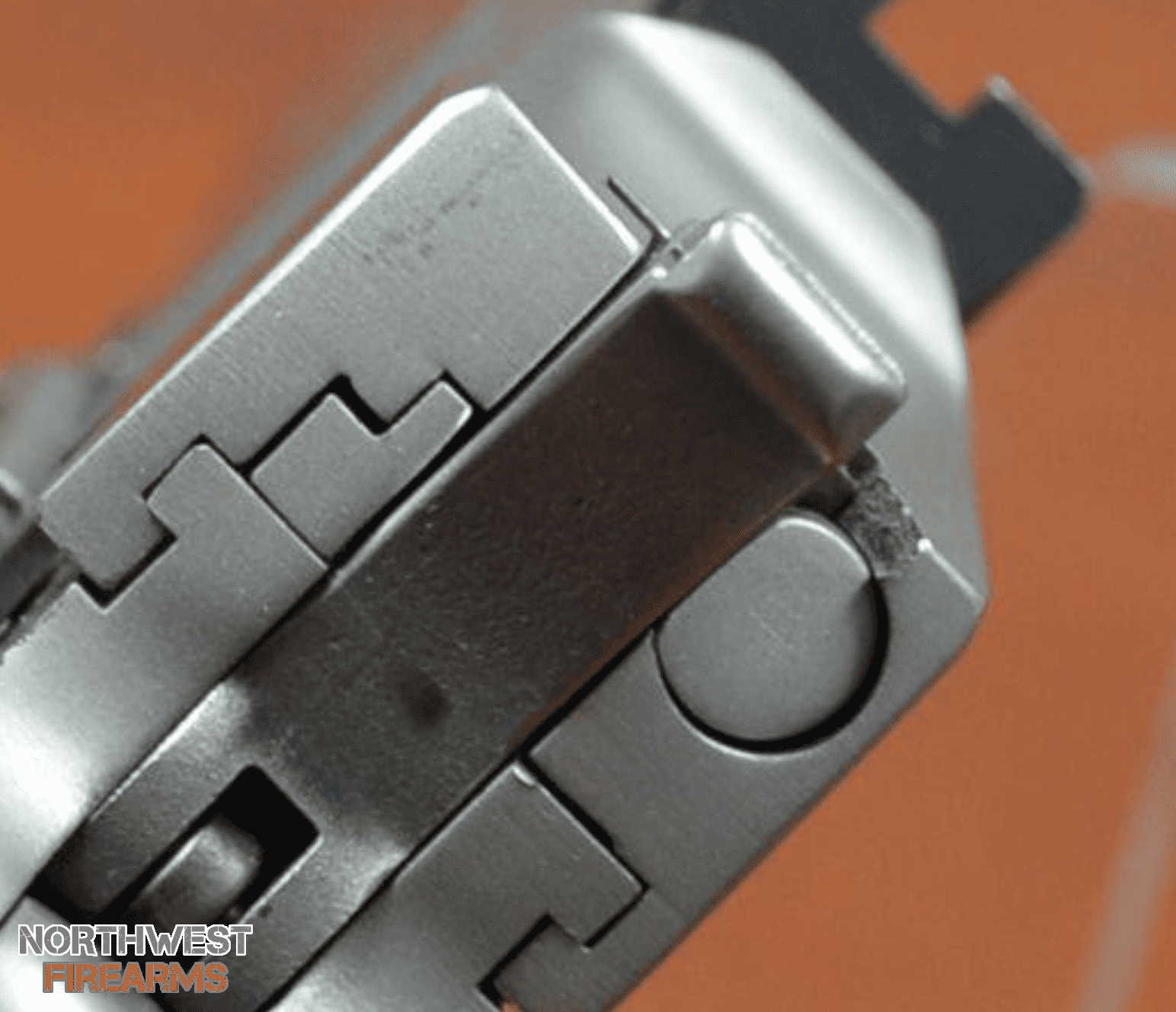

First pic is my gun, second is a different gun.
Looks like somehow the firing pin stop along with the extractor has caused that portion of the slide to break off.
The top picture looks like somebody milled a radius to repair the jagged edge when the same thing happened previously.
Now, the only thing holding the firing pin stop and extractor is the top left side of the slide.
That's a normal point of break on those slides. It's very fragile in that area...you're not the first with a broken ear at that point.
Appears in the first pic, someone smoothed out the break area and made it look more factory.
The missing bit would be a cosmetic issue (irritating as all get out) and should not be a functional issue. IIWM I'd contact https://www.caspianarms.com and ask if they can tell you the alloy, should be easy to have it welded and recontoured. 90percent certain Caspian was the supplier been ~40 years I could be wrong, WTH memory isn't what it was.
FWIW many times guns that were returned for reliability problems wound up being shooting technique. This gun requires a firm hold. No limp wristing. They were tested with Remington 185 jhp and 230 ball. I've never had problems that I remember with any factory ammo YMMV.
