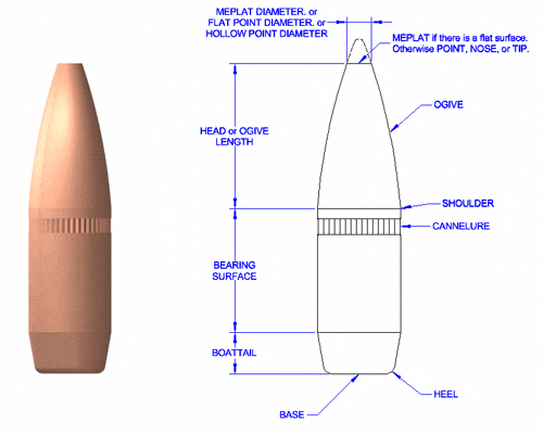

Jim, I don't use those case gauges. Maybe MY 9mm rounds would do the same as yours? I use the "Plunk Test" and adjust OAL accordingly. The issues I've run into is the Montana Gold bullets I use have a taller "Bearing Surface" than other bullets. I need to shorten my OAL for two of our 9mm guns so their chambers will accommodate the MG bullets. I take into account for shortened OAL with powder load and watch for pressure signs.
