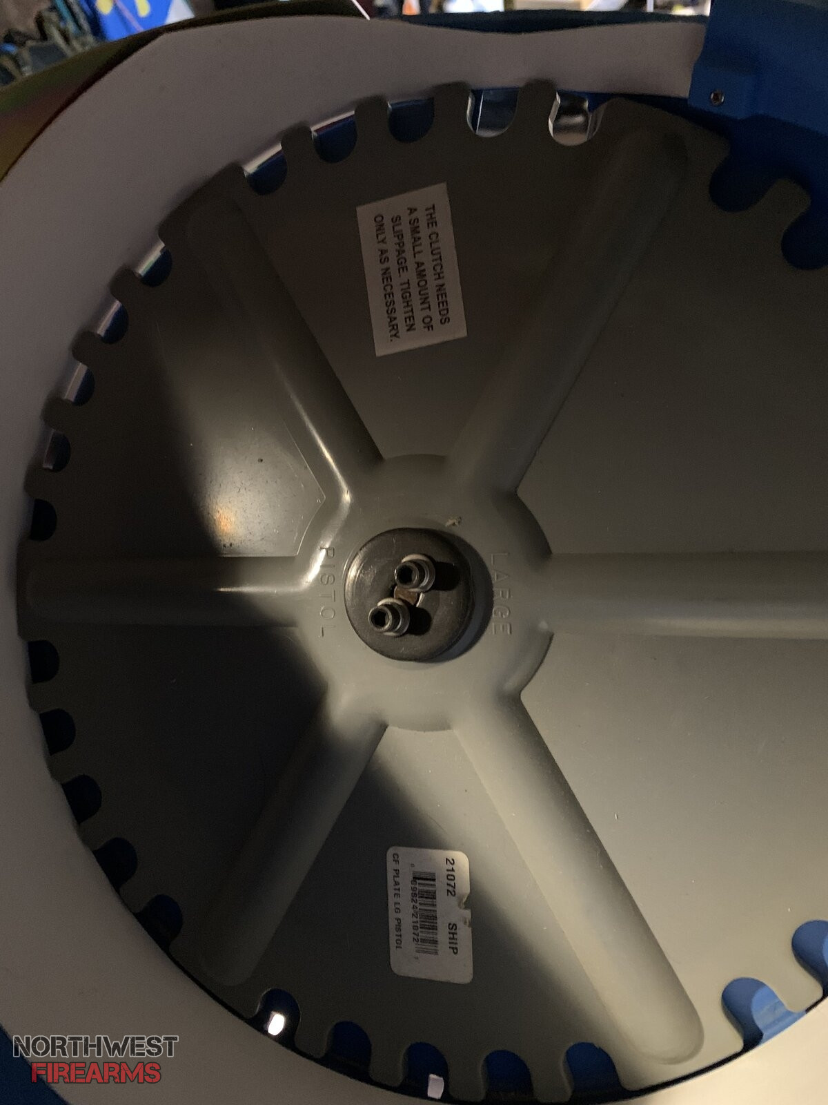

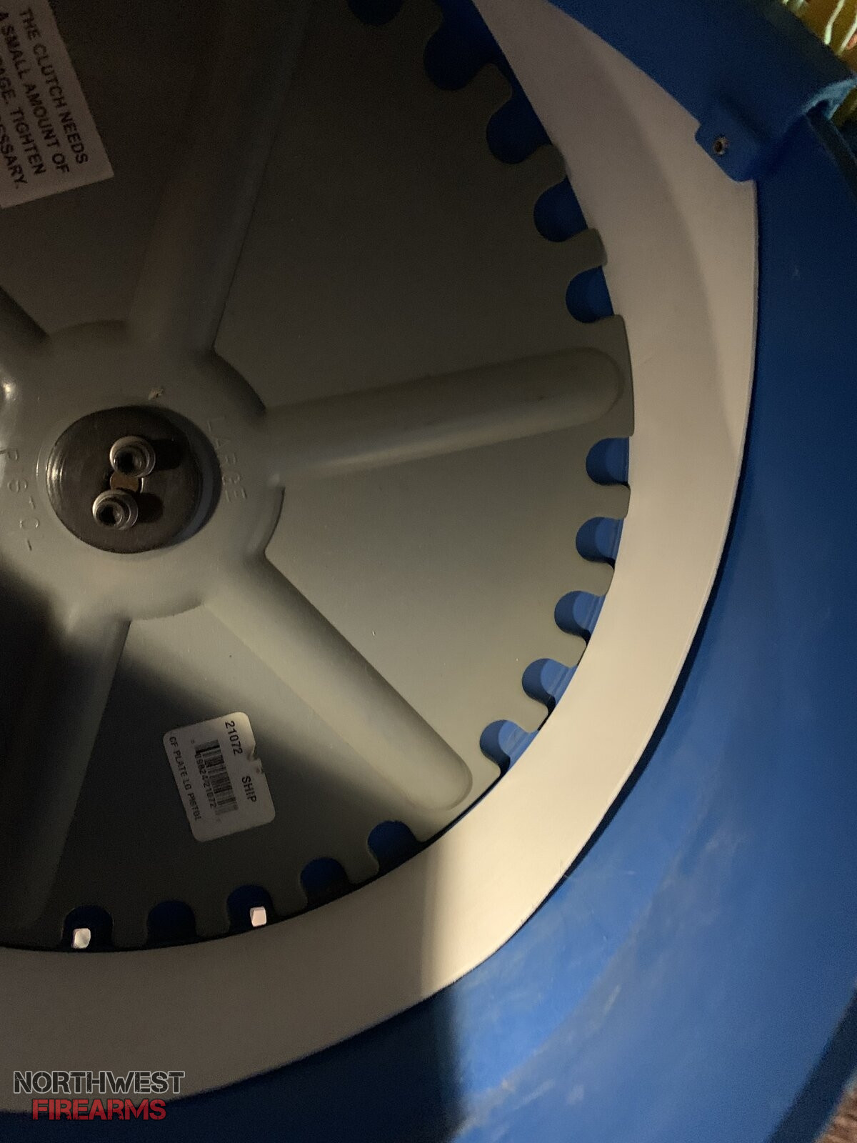

Where do they jam? I have loaded thousands of rounds of 9mm and I have never had a jam problem with the case feeder on my 650. I do have the older dillon case feeder.
In the funnel where they drop out from the case feeder.
That was my guess, but I have never had that problem with the case feeder set to low speed or high speed. My case feeder is about 25 years old. It doesn't have the removable side plate on the bin I see in the new photos.
Are the cases falling too fast and jaming each other or is a case falling sideways and jaming the funnel. Are the case not falling imediately when the U hole clears the side of the case feeder?
Are you lubing the cases before you put them in the feeder?
I use my one and only case feeder for 9mm, 45 acp, .30 carbine, .223, 6.5x55, .308, 30-06 and 8x57. 30 carbine gave me problems before I found out I had to raise the plate by adding a washer under the center hub. All others have feed without issue.
One will fall or bounce sideways, then the rest pile on top till it's raining brass. :D
