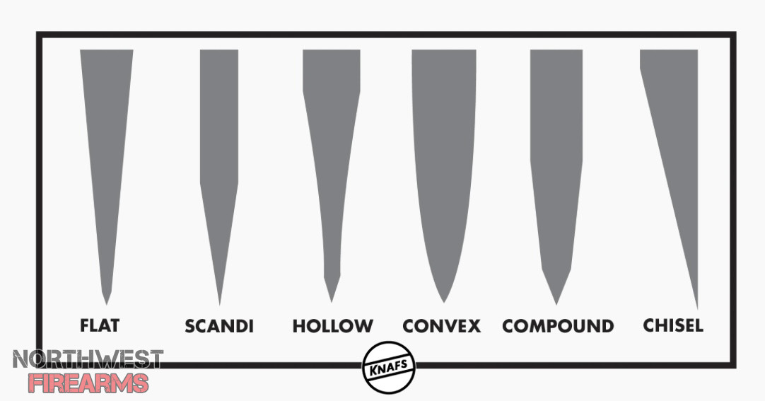

I've had thin hollow grind blades that perform amazingly well. Have one that I used basically as a machete for 1/4 mile trail clearing of blsckberries, then kiddo used it to carve 2 walking sticks, then I used it to cut delicate fruit. Never lost any sharpness. I was blown away and since then have tried to always get similar blades that use hollow grind to taper to a thin point. The concave hollow grind pushes away whatever you are cutting as you cut. And if that concave portion goes a long way, like almost to the spine, it is incredible at skinning or cutting most anything because you have a thin blade at the edge, enough strength as it gets thicker toward the spine, and almost the full length of the blade is pushing away whatever you are cutting. Think of it like pulling two ends of a rope as you are cutting. That is sort of what the concave surface does. That same steel in a thick blade is a pain in the bubblegum and never seems sharp enough.
Example of hollow grind blade where the concave portion goes almost all the way to the spine and thins down to a razor sharp edge.
I'll let others more knowledgeable than me speak to steel specifics but that's a widely used and highly regarded steel. To me what's more important is blade geometry.
