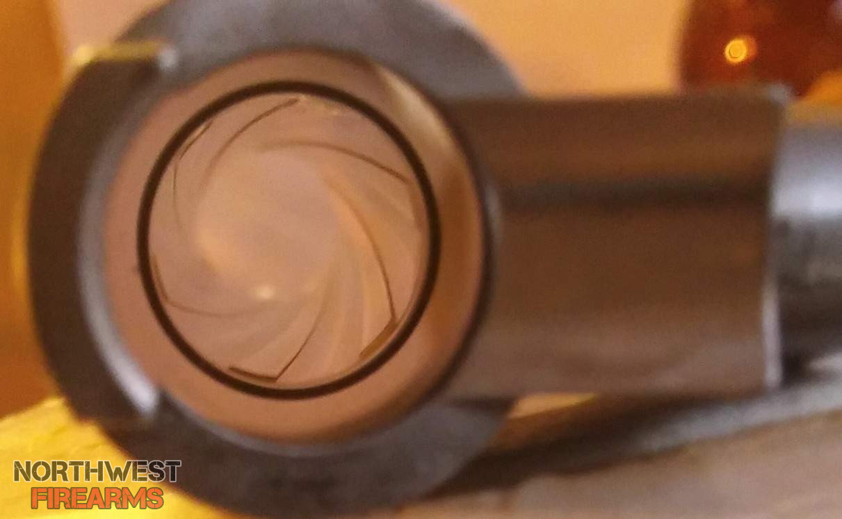

follow up. I gave it a round 2 tonight.
I broke out my old brass brush this time and some elbow grease with Hopps 9 and kept at it until it came out clean with a patch. Then I followed up with a patch with a light coating of CLP to oil and lube the barrel.
I think the difference was my nylon brush is either not tight enough (significantly looser fitting than the brass brush) or nylon is just ineffective and stubborn fouling.

Doesn't look bad in the first few inches :) Keeping the rod rotating is good, otherwise you skip over the land/grooves transition rather than following it along the edges.
I also find that once it's loosened with a decent cleaner, that the dry patch matters - more that if i use a patch puller, it's crap, doesn't clean the aforementioned transitions well either. I had already moved from pullers to placing a patch over my brush; i've since discovered that jags are where it's at - totally worth it.
