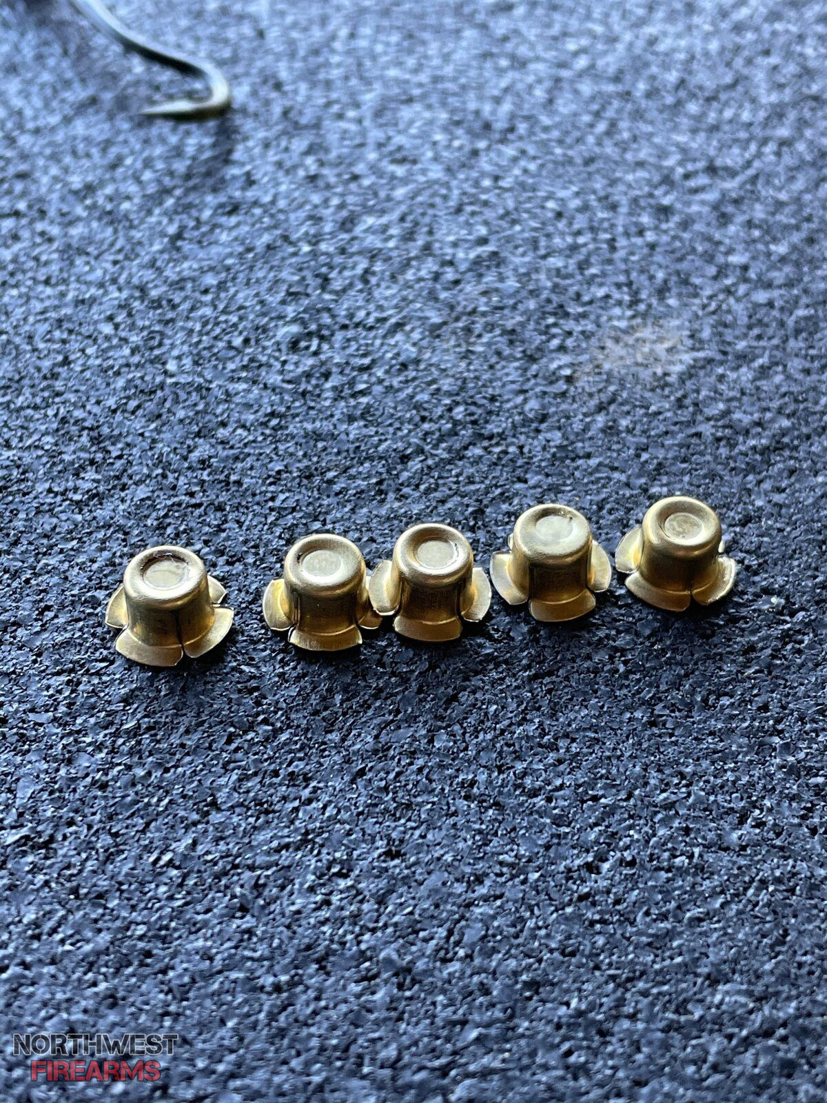

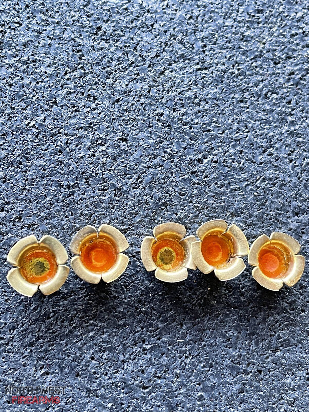

This is my first muzzleloader. I recently received a new box of musket caps and the first five attempted did not ignite. I had one of those CCI reenactor musket caps handy and it ignited fine in my rifle. Trying to figure out if I have a problem with my striker or with the new musket caps. Thoughts?
Here are the five that did not ignite.

V.odd looking caps, them.
What brand are they? And when you say 'striker', what do you mean? That's a strange-looking impact mark.....

This is a good reminder. I did not do this yesterday at the range, though I did visually inspect the bore and breech plug before loading. So just now I went into the backyard with an empty chamber, taking two of the CCI reenactor caps and two of the caps in question. Both CCI caps ignited fine, but the two caps in question again failed. In the picture below, the CCI are on top (copper) and the caps in question are on bottom (brass). I also noted that the CCI caps seem to fit the nipple well - I can feel a tactile snap as they set into place. The other caps do not snap into place, but they seem firm. After being struck, the firing compound from the mucket caps in question often crumbles into a yellow, course powder.
My rifle is a Traditions Vortek Strikerfire Northwest Magnum in .50 cal with a musket cap nipple. It's an inline rig with a removable breech plug.

From the looks of the musket caps and what you say about seating, I wonder if the caps are seating far enough onto the nipple that the ignition charge is being compressed.
Can I do anything about this? Softer placement? Or are you suggesting that these caps and my musket nipple just won't be friends? Is that common?

The CCI caps are not hot enough for hunting loads. Use RWS caps. My guess is that you're not getting a good seat on the nipple. The caps could be junk, I don't know how they've been stored. If you've dry fired the rifle without a cap, the striker can expand the nipple and give you a problem with seating them. Nipples wear out by expanding after a lot of use. Try a new nipple and see where that gets you.
