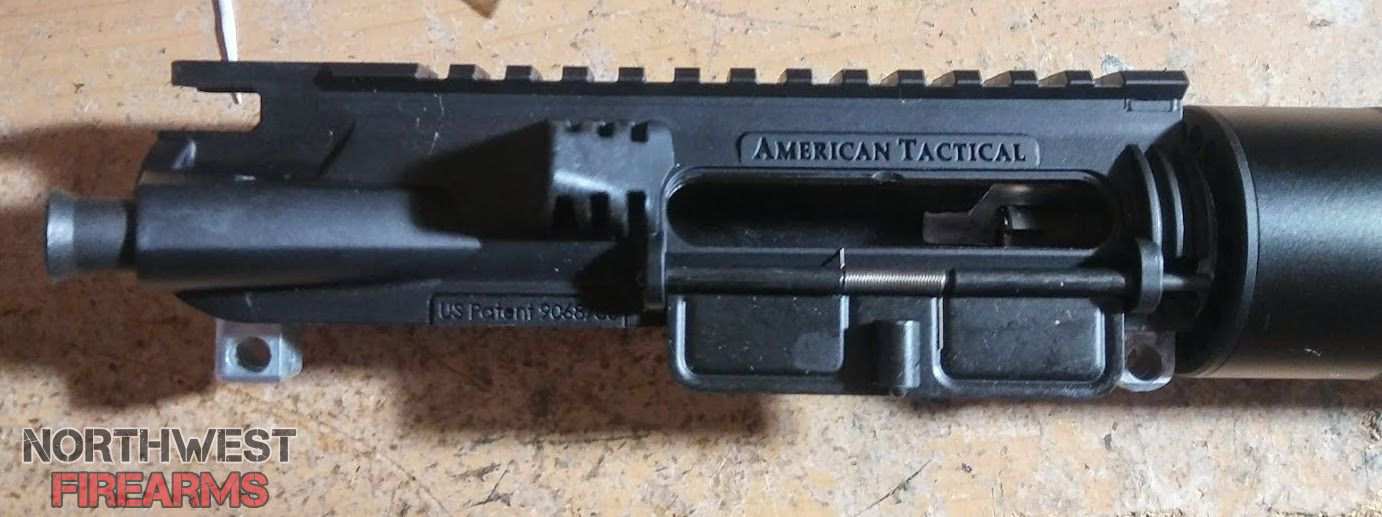

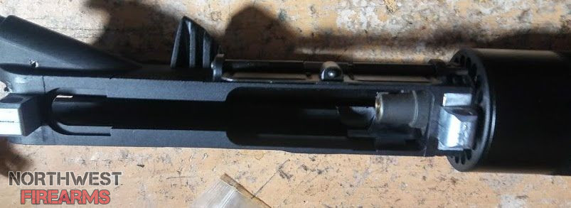

Both Uppers come with Collar. With this collar, you simply use your existing CMMG, Spikes, Ciener .22 conversion kit pop out the chamber adaptor and insert the collar and install it into the upper.
**FYI: The legal 16" barrel goes inside the receiver approximately 1.5" so the barrel looks like a true military 14.5" length. The barrel also comes with the end threaded 1/2 x 28. This barrel utilizes the correct 1:16 twist rate for the .22lr bullet and eliminates the problem of fouling AR15 gas tubes with dirty rimfire ammunition.
.22 Flat top floated carbine upper $245
This uses 16" spikes lightweight barrel. It was drilled for a front sight base but pin holes covered by a free float tube. The receiver is a synthetic lightweight flat top receiver. Comes with a .22 conversion collar.
