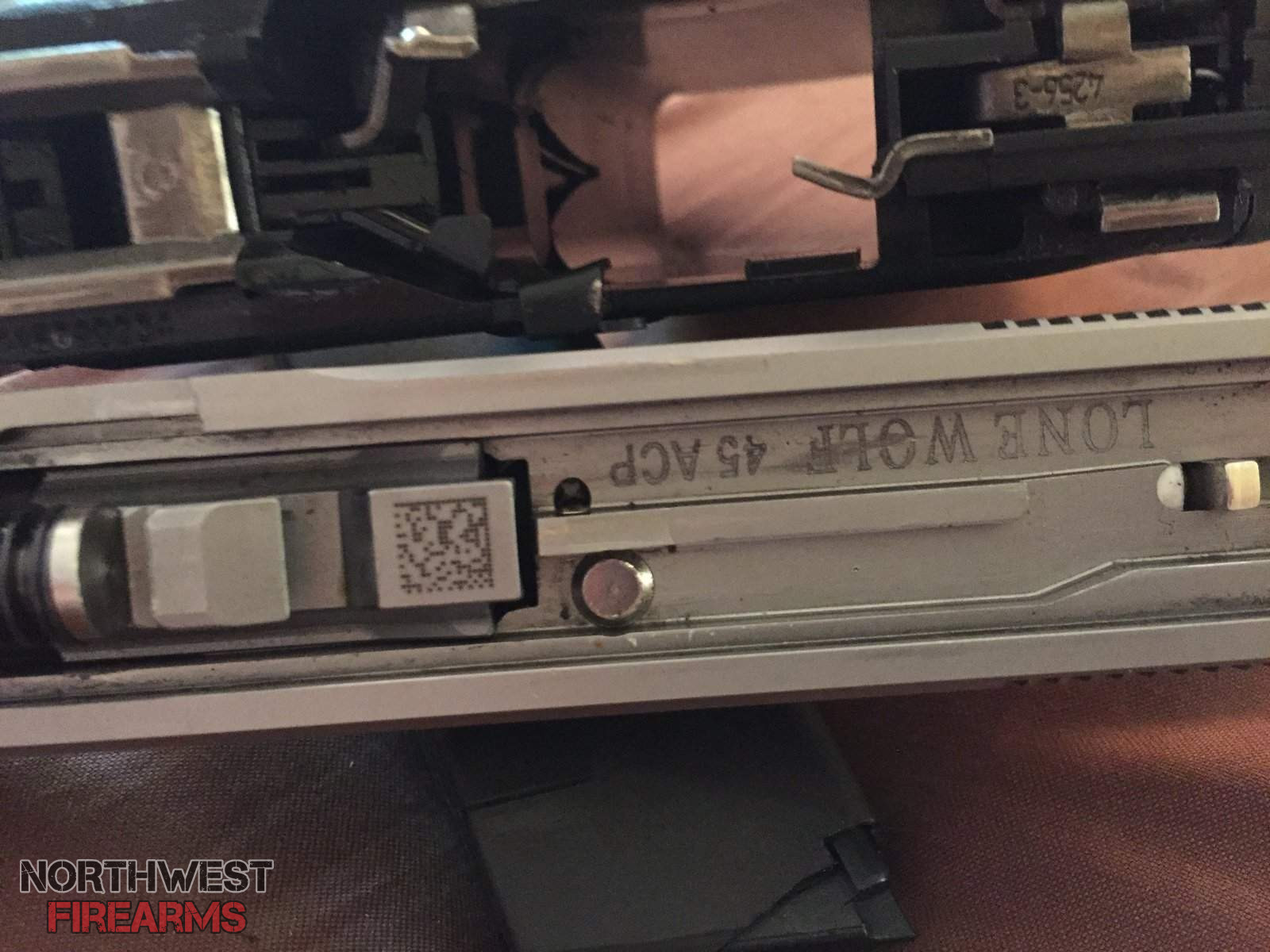

If I have a (dummy) round in battery, pull the slide back 3/8" and release, it usually will not go back fully into battery, where as on my 10mm glock, it usually will. So there seems to be some extra resistance there. I popped off the extractor, and checked the spings, firing pin safety etc. and they seem in good shape and functioning correctly. I did notice this
That smear accross the OLF of wolf is not dirt, but a metal on metal scrape. If you look at the ejector, you can see similar wear. The ejector does look a little proud, and has to be pressed down to slide the slide back on to the gun.
Should I file down the ejector, bend it down, or do we think there is another issue?
My initial thought would be to file down the ejector, as it's a cheap part that's easy to replace. Maybe file it down until it clears the slide, then polish it up to remove the file marks and retest.
Does different ammo work? Does it go into battery without ammo in it? If you point the empty gun with no mag upwards at the ceiling and let the slide go into battery very slowly will it go in completely? (some of the things I had to make sure were working when doing my 80% glock kit recently)
Yes, it does work empty, slow, vertical. But I do think you are onto something with gun itself rather than the ammo.
