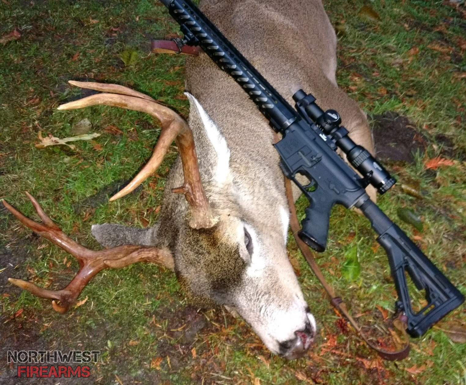

While I chose the 458 socom, I can attest to the effectiveness of big chunks of lead moving at moderate speeds.
