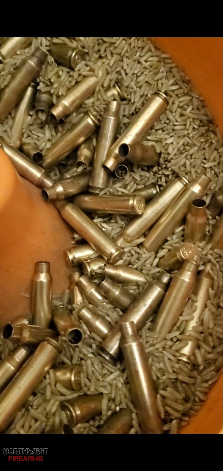

I think I have the basics for everything I need, I'm just waiting on delivery and gathering some components now. I'm sure once I really dig into things I'll find out I need something else, but I started some basic cleaning on some .223 brass today.
About an hour in rice with a couple wads of nevrdull. I just got some actual corn cob media, nu finish, and mineral spirits at bimart so I can give another batch a run and see what it looks like. Still haven't made it back home yet, I'm picking my daughter up from school on the way. The rice did a pretty decent job, but dumping those cases out was a little annoying.

I got mine used. Before that I had a wire basket, in a plastic tub, and would pour the brass and media in that and shake it until most was out. Then i'd take it outside and toss it in the basket until it was empty. I also have a compressor and blew the dust of as best I could. And I'd put the brass in a pillow case and shake it around good the get the rest of the dust off.
Any tips on cleaning the inside of .223 cases, or does it even matter as long as there's no debris?
A lot of us have switched from vibratory case cleaning to liquid tumbling with or without steel pins. Gets cases shiny clean inside and out. Even cleans primer pockets if you use the stainless steel pins. I use Dawn and Lemishine and only use the pins on really cruddy brass.
