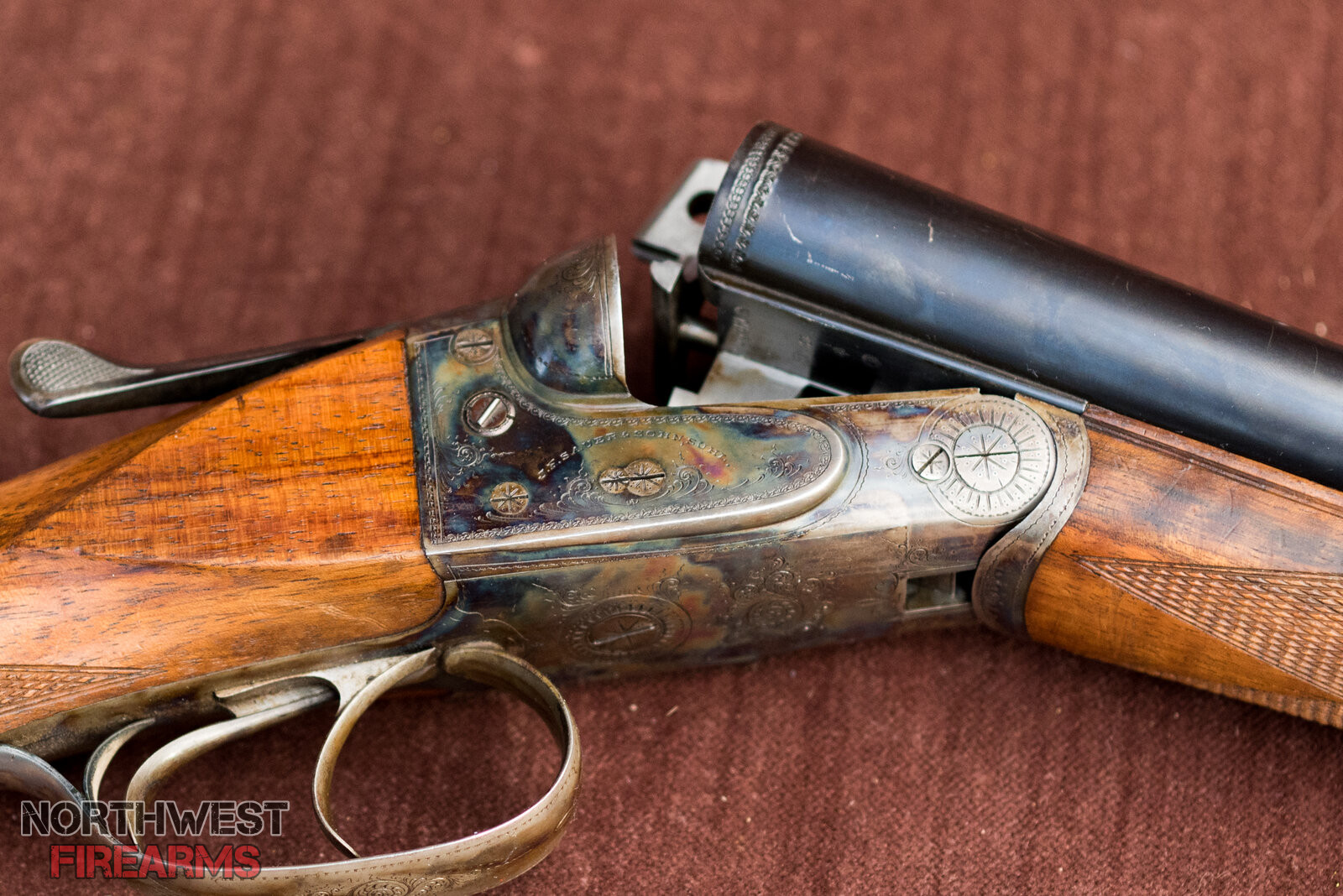

It's more than just a surface finish. I'm not sure exactly how deep, but a case colored part can be refinished if there is surface rust or scratches.
If you take a chunk of steel and heat it with a torch to a black/blue, that coloring goes down more than surface deep. This is similar with the case coloring.

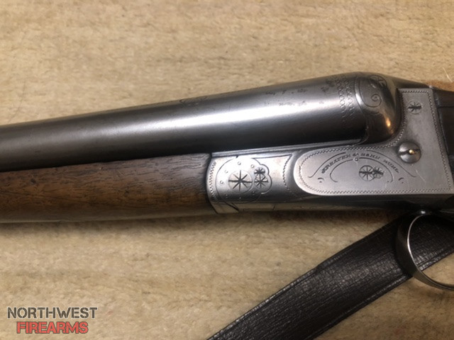

As others said it's just the surface. If u take care of it it will last. If u leave in the sun or always get sweaty hands on it it won't last. Here's my SxS 12 gauge made in 1913, holding up well. I have another made in 1951 and case hardening is completely gone except for under the wood.
1913
1951
