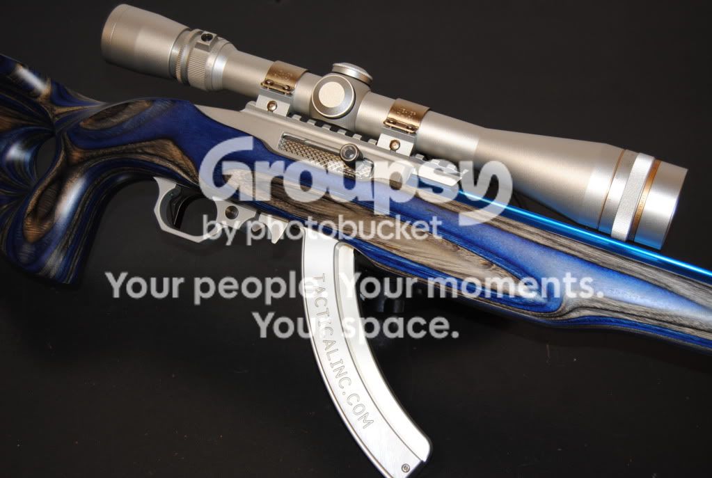

    I have 2 tactical innovation aluminium mags like in the photo above (you can get them in colors as well, mine are black). They are fantastic, no issues, but usually a wait and somewhat expensive. You'll never buy another plastic mag again however.
    Bonus, they are based out of Bonner's! So you'd be supporting NorID and a Northwest dealer.
    Also a good reason to go with Nightforce, beside a great product, who hail from the very weird bizarro world of Orofino.
