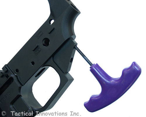

    7075 Billet is stronger than forged aluminum. Above poster is refering to 6061
    If you want the best get a Billet lower that has the mini reciever cincher. Not sure what its called exactly but its a rod you can adjust to tighten the play between the upper and lower reciever to the point it is about gone which makes for more accuracy, especially on follow up shots. I bought the Tactical Innovation T-15 BDX and love it. I have adjusted that little thing to the point I literaly have 0 play between my recievers. I love it. The billet looks so much better too...
    (Click the link and READ THE WHOLE PAGE for description of features)
    It's only $160 now!? I paid $250 for this reciever a year ago...
    http://www.tacticalinc.com/t15bdx-bi...er-p-1082.html
    adjustment feature

    Quote Originally Posted by RallySoob View Post
    ...adjust to tighten the play between the upper and lower reciever to the point it is about gone which makes for more accuracy, especially on follow up shots.
    Quote Originally Posted by JC Weaponry View Post
    Accuracy in the AR15 Platform has nothing to do with upper to lower fit.
    Barrel to Receiver Fit (Proper Torque)
    Bolt to Barrel Fit (Proper Headspace)
    Barrel Twist
    Bullet Weight
    Chamber Type (5.56, .223, Wylde)
    Those are the Main Accuracy Concerns
    You do not think play between your upper and lower reciever effects followup shot accuracy? Is that what you are saying? If so, you are dead wrong... Also, have you ever seen a competition bench setup? ...0 play, heavy billet everything... less flex equals more accuracy. ever seen an AK47 in slow motion? ya flex is bad...
    edit: Oh wait...now I remember you wwaahhh wahh
