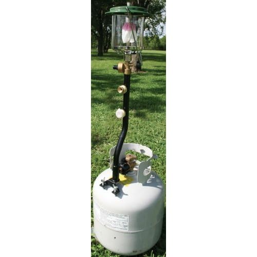

    Do you mean the LP tree?
    Like this?
    Bi-Mart used to have them. I'd be surprised if they didn't still.
    Here is Coleman's site with them:
    http://www.coleman.com/coleman/colem...d=27400&brand=
    And another:
    http://www.amazon.com/Camp-Chef-Delu...d_sim_sbs_sg_4
    And yet one more:
    http://ecx.images-amazon.com/images/...0L._SS500_.jpg
    They are just the stand pipe. You have to attach the lantern and heater units.

    Another place to find fittings is in the RV sections.Get one of those "extended stay" kits.Camping world has a good selection ,pricey but a good selection.
    But as RVTech said,take the tree and all your parts to the plumbing section at the hardware store.(make sure to get a roll of teflon tape too). If you play around there for a while you can come up with any configuration you want.
    But don't expect the staff to have a clue about it.
    Do y'all have any propane/BBQ stores down there? Sometimes they will have a good selection of fittings too.
