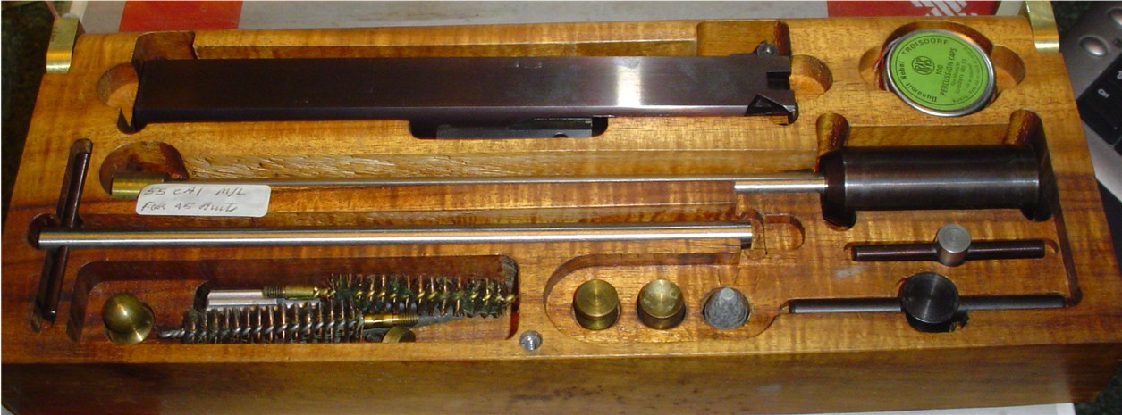

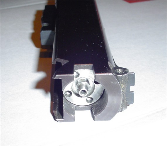

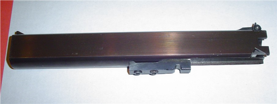

    Anyway, I have a 54cal muzzleloader conversion for a 1911 in front of me. It came from someone very famous in the gun industry, and was custom built for him by yet another firearms icon. I will post a few photos of it tonight so you can see how it was made!
